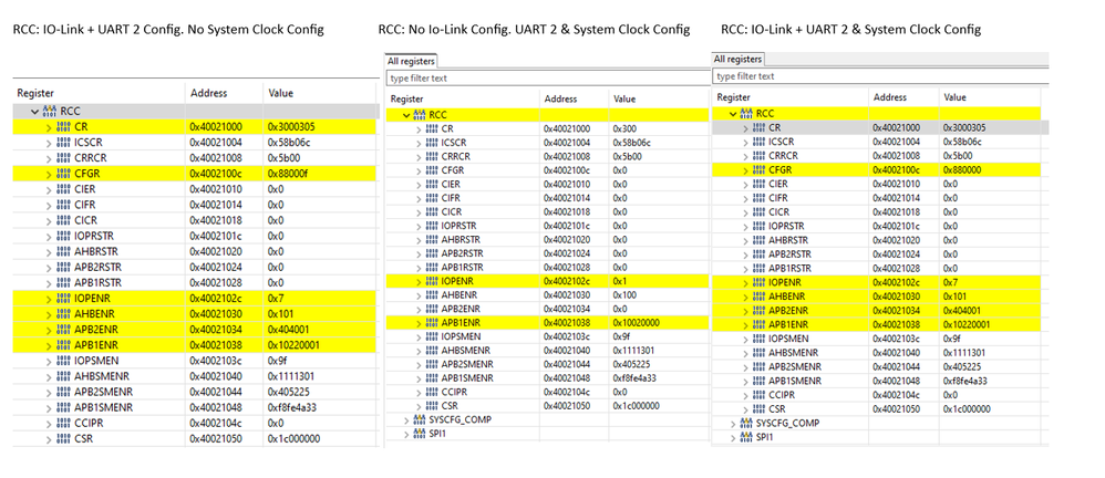

The problem is when is called the function "HAL_RCC_ClockConfig(&RCC_ClkInitStruct, FLASH_LATENCY_0)!" in the "SystemClock_Config();". I think there is some registers that are not configured correctly due to the overwrite, but after several configuration I can't fix the problem.
Please, refer to the three files of internal MCU registers and to the RCC comparison tables:
