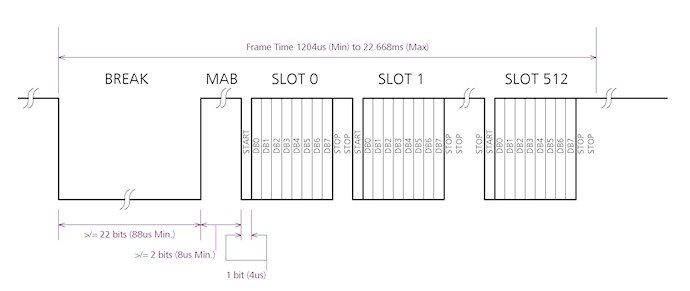

ismail fatih iltar wrote:
2)i need ~100us low pulse at uart. so i send zero at SET1 baudrate than i change it to SET2 normal comm. baudrate.
I'd really like to understand this better, please. Can you explain this mechanism in more detail?
2018-06-28 9:02 AM
purpose of low pulse is break condition before data. i must handle the tx line app. 100us at low so if i right, i have 2 ways. first one is setting pin tx to gpio and set it to low after that init like a uart again. second one ise changing baudrate dynamically. So i change baudrate to SET1 and send 0x00 to uart to simulate low pulse after that i change baudrate to SET2 to send my datas.
2018-06-28 9:31 AM
Thanks for the explanation. That's what I thought - I definitely would have just flipped the pin into/out of GPIO mode (with the 0 set in the ODR bit at initialization). Much quicker, much simpler.
