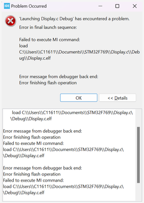

2024-09-27 2:22 AM
Hi, now I've attached the screenshot of that error message
2024-09-27 2:30 AM
You can paste into the post - then we can see it more easily:
So it's failing to load the .elf file - ie, your code.
Does that .elf file actually exist? Did you successfully build your project?
And, again, are you sure that your computer is actually seeing the Disco board's ST-Link?
If your computer can't see the ST-Link, then it's clearly not going to be able to use it to load your code...
