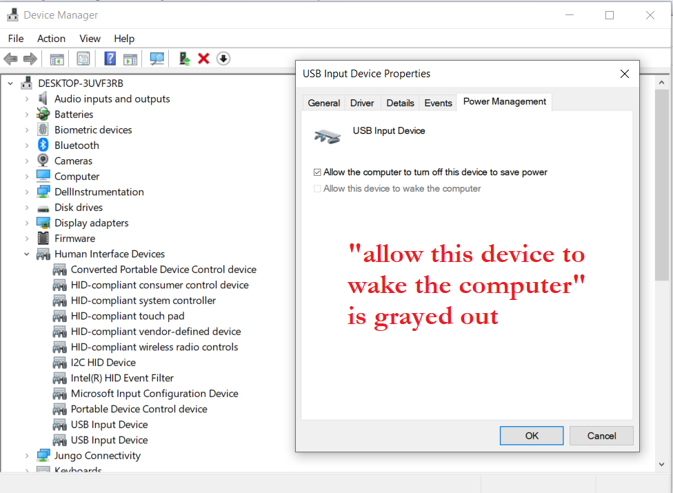

FYI - your suggestion is problematic. I found that the section for "Allow this device to wake the computer" is grayed out (Windows 10):

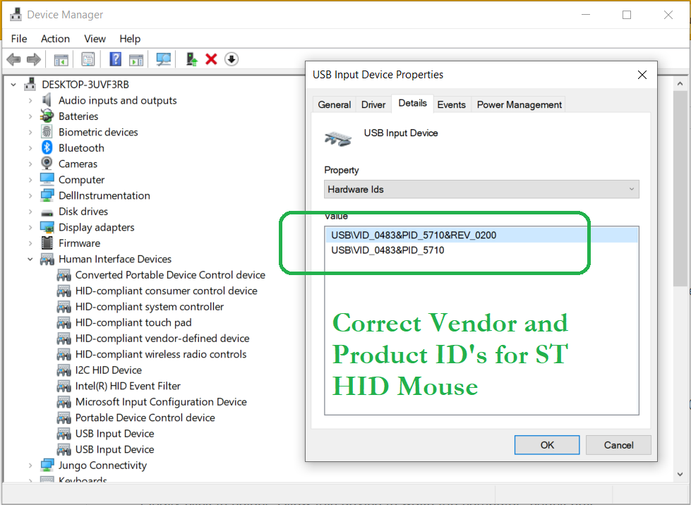

I found this under "Human Interface Devices". This is the correct vendor and product ID:

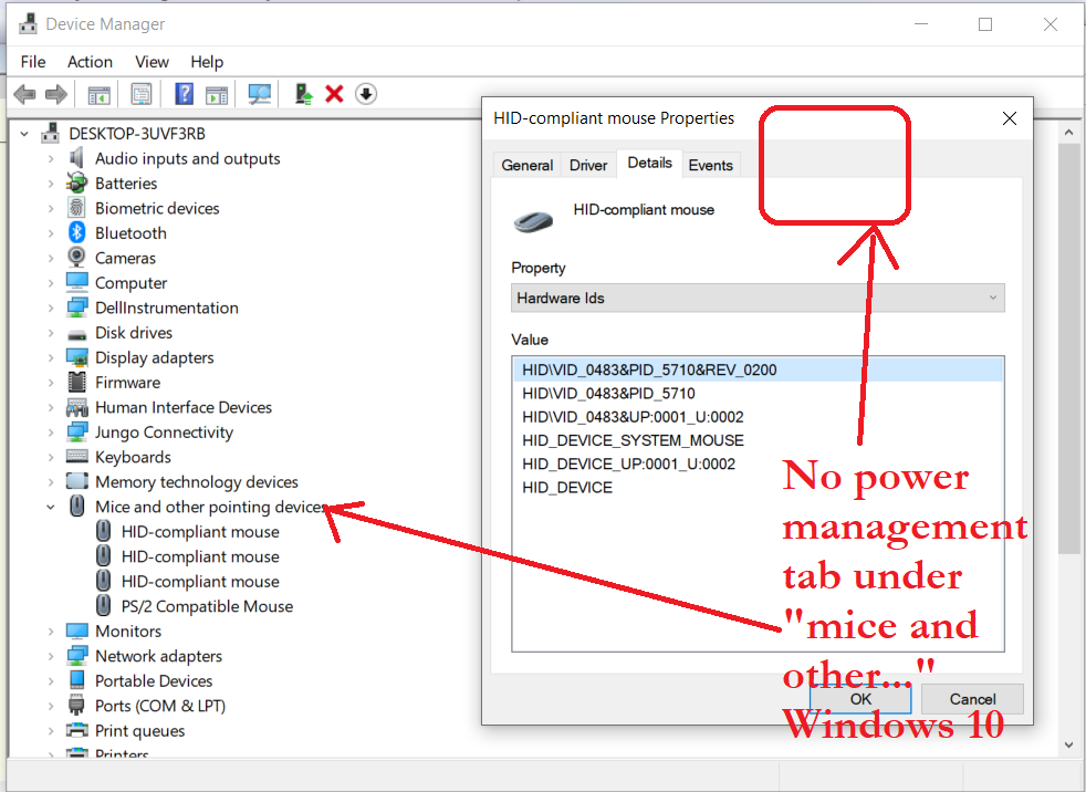

And also interestingly, I found that under "mice and other pointing devices" (Windows 10) there is no tab for power management at all, so the instructions that you gave are also not compatible with Window 10 (or at least my instance of it):
