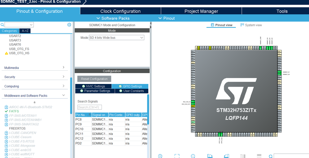

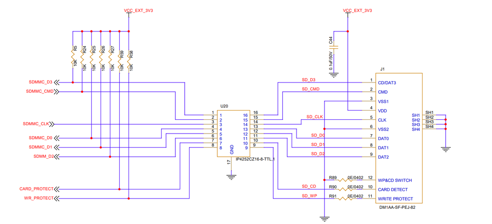

2024-07-10 4:30 AM
Hi SHs,
i am using 3.3V with pull up register 10kohm.
2024-07-10 4:33 AM
Hi Naresh_,
If you are using an ST Board, try to run the examples provided in the package.
If you have your own board, pls check the connection between the MCU and your uSD card connector and make sure you are configuring correctly your pinout using CubeMX.
Best Regards,
Ismail

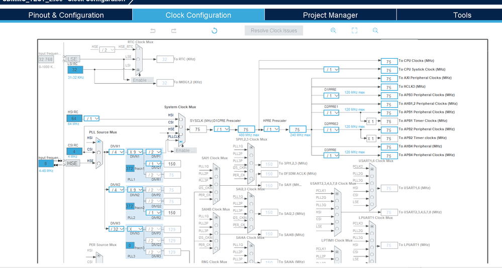

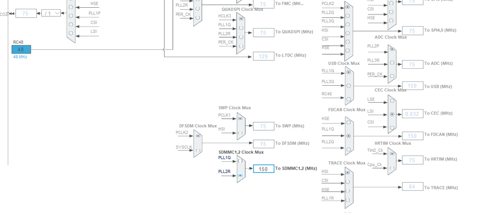

2024-07-10 6:58 AM
Hi Naresh,
Your setting should be ok. I understand that you are using your own board ( not ST board).
Could you plot the signal SD_CLK and SDMMC_CLK, just after the fail?
Second point, what do you mean by old SD card?
FYI, the driver support all uSD cards with capacity not exceeding 32GB.
