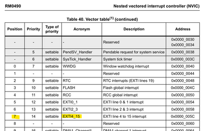

2024-07-31 7:07 PM
You can find the vector table in the reference manual.
The documentation for the ISER register will be in ARM documentation, since that's part of the core.
