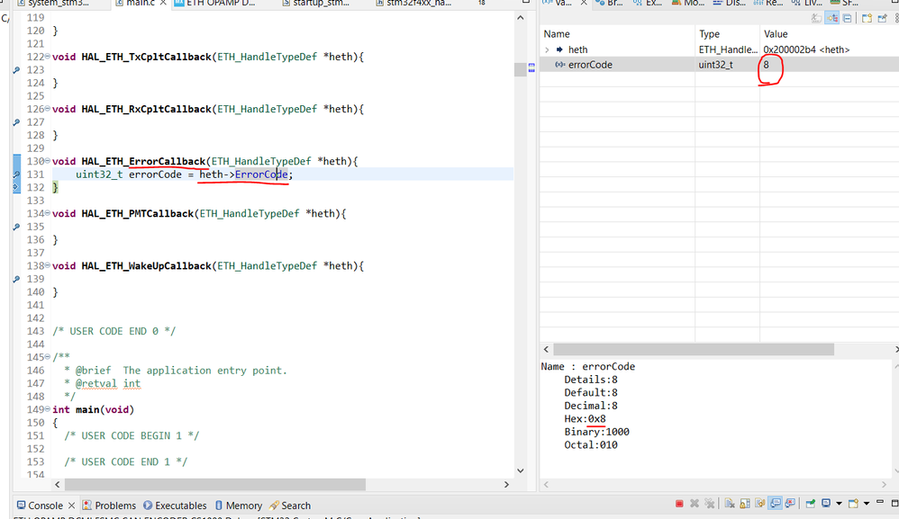

Then my activity LED blink on the DP83848 and then I get an interrupt.
I get the error code 0x8. That means I'm facing DMA issues. But why?

*/My STM32F407 does not have DMA for Ethernet. What should I do now? Is this a bug?

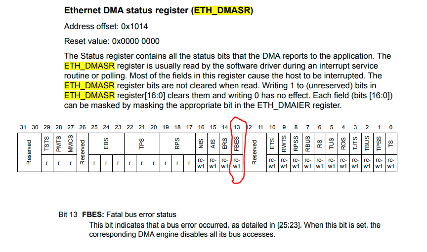

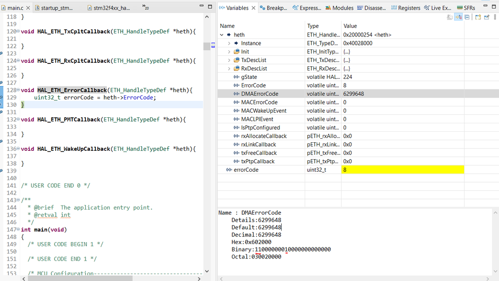

Here is more information. I found a DMA error code.
Here comes the error code from. See arrow.
/* ETH DMA Error */
if (__HAL_ETH_DMA_GET_IT(heth, ETH_DMASR_AIS))
if (__HAL_ETH_DMA_GET_IT_SOURCE(heth, ETH_DMAIER_AISE))
heth->ErrorCode |= HAL_ETH_ERROR_DMA;
/* if fatal bus error occurred */
if (__HAL_ETH_DMA_GET_IT(heth, ETH_DMASR_FBES))
/* Get DMA error code */
heth->DMAErrorCode = READ_BIT(heth->Instance->DMASR, (ETH_DMASR_FBES | ETH_DMASR_TPS | ETH_DMASR_RPS)); <<--- HERE!

}It looks like DMA is disabled for ETH?

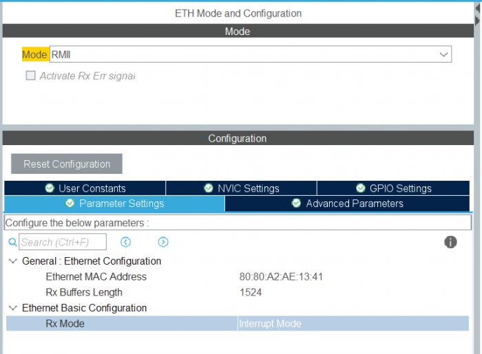

Where in the code RX buffer memory is assigned to the RX descriptors?
Have you reviewed any ST Ethernet example? Especially, file ethernetif.c.
2022-04-18 10:12 AM
The RX buffer has STM32CubeIDE self been generating code for.
There is no ST Ethernet example for the 407 processor.
