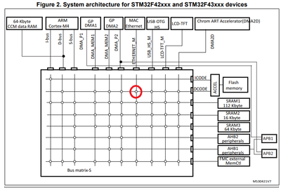

2025-04-07 8:45 AM
@user 143 wrote:
Can anyone confirm that the STM32F407 Ethernet DMA cannot access the flash?
For STM32F42x/STM32F43x (figure 2), they have access to the flash:
I need to check internally for STM32F407.
