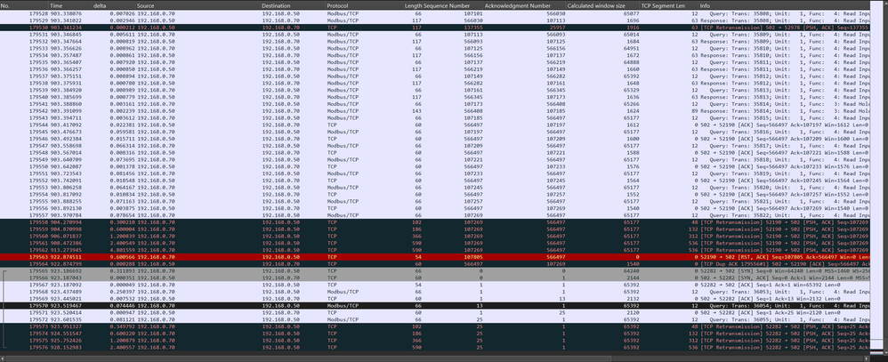

2025-10-10 3:55 AM
Hello there, this Re-connection Problem engaged me till now.
I only want to share my fixings for this Problem.
At First I am not complete sure of that all these Fixings are needed.

#define LWIP_DNS 14.Solution - I add some Timeout Handling to the Modbus TCP and OPC UA to free my lwip rescource to start a new connection when it is necessary - This looks very good.... At First.
But this only make a different Problem occur.
I think this a unique one - Because I have very lot of Data and Task which block my Controller Resources.
Now the Connection dont work any more after a sporadic time and ONLY when i pull the Cable - wait 5-10sec - attach it again.
For Example the Test Sequence:
1. Start the DUT
2. Connect Modbus TCP (do some Communication, i poll some Input register very fast for 8ms)
3. wait 1-2 minutes
4. pull the Cable - wait 5-10sec - attach it again - do this 2-3 times
5. wait now 10 minutes
6. When the Connection works fine pull the Cable - wait 5-10sec - attach it again - do this 2-3 times
7. wait now 10minutes
8. The Error can occurs sporadic.
This can i retry a lot of times, but the Error can occurs on a sporadic time.
It looks like in the ethernetif.c, which was generated with STM32CubeIDE trigger this Problem.
* @brief Should allocate a pbuf and transfer the bytes of the incoming
* packet from the interface into the pbuf.
* @PAram netif the lwip network interface structure for this ethernetif
* @return a pbuf filled with the received packet (including MAC header)
* NULL on memory error
static struct pbuf * low_level_input(struct netif *netif)
struct pbuf *p = NULL;
if(RxAllocStatus == RX_ALLOC_OK)
HAL_ETH_ReadData(&heth, (void **)&p);
return p;
}What exactly TRIGGERS the situation when pulling cables? Flow example:
Link Up → Burst an ARP / DHCP / mDNS if applicable.
Very fast input several frames → Rx DMA, for example, 8–10 buffers → pool (12) are almost empty.
One or two more frames → alloc fails → RX_ALLOC_ERROR.
At the same time, your input task may still be in initial processing or is currently waiting for RxPktSemaphore.
Because of if(RxAllocStatus == RX_ALLOC_OK) it will NOW NOT be picked up any further → the time when the older buffers could come to the stack and be released later will be postponed.
Only when lwIP (TCP/IP Thread) releases the buffers that have already been passed on will your pbuf_free_custom() reach the code path again that sets RxAllocStatus to OK and posts Semaphore. T
This happens “sporadically” – depending on stack load, offload, timer run.
Cable pulling itself does not directly create the error, but rather increases the time window between feeding (frame burst) and processing.
Why doesn't it happen:
Because at some point you will ultimately get pbufs free (TCP/IP stack releases them → custom free → reset flag). The mechanism recovers – but with latency and unclean pattern.
5. Solution:
return p;
In Conclusion:
Perhaps this Problem occurs only because on my Sytem, because i use a lot of Resources of the Controller and poll with some data with 8ms on ModbusTCP.
When you have some Re-Connection issues perhaps try my Solution 5 without:
