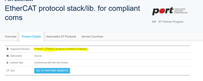

unfortunately the STM32H7 series is not supported in the port of EtherCAT protocol stack/lib supported by ST as shown in this screenshot below
more details on this in our website.

Hello @Legacy member ,

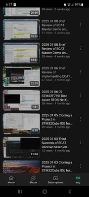

Please watch my YouTube for implementation of ECAT master base on stm32F7x and Stm32h7x. Prof. Woonchul Ham
https://www.youtube.com/watch?v=AK2MHlrzZrI
