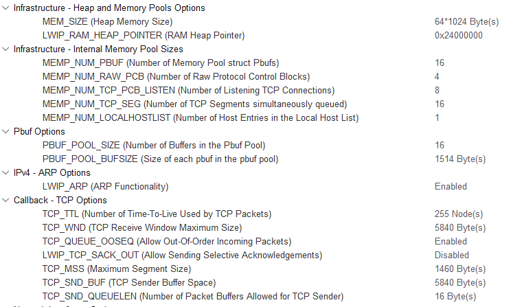

There, my LwIP configuration:
Starting from these, on the ETH side:
On the LwIP side (my nightmare):

On the LwIP side (my nightmare) (hope it won't be anymore):
How several memory-related parameters should be calculated according to others ones?
you need to calculate the starting address of the LWIP heap depending on the last address of the RX buffer to properly align all the parameters in the same SRM region to be able to do the proper MPU configuration in one region if needed. this can give you better flexibility in the placement of your allocated memories as you can change the placement to a more rapidly accessed memory for your specific MCU( DTCM ,AXISRAM,SRAM1,SRAM2,external memories using FMC OR OCTOSPI interfaces ...)
How much heap shall be allocated?
Thins depends on your application needs for handling tcp/ip stack and other high-level application protocols (http, ftp ...)
Is the configuration above is coherent or I'm wasting/missing memory?
you are placing descriptors and Buffers in SRAM 3 (starting with 0x30040000) which is connected to the Ethernet MAC using 32-bit AHB bus matrix in the D2 domain and placing the LWIP heap in AXISRAM (region starting with 24000000) and you are allocating 64 KB for the LWIP HEAP this can be reduced or added depending on your planned usage if you are not really in need of it you can reduced and place it alongside the buffer and descriptors in the SRAM3 .
