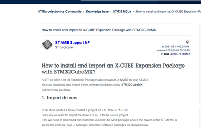

2025-02-21 1:47 AM - edited 2025-02-21 1:48 AM
Hello @manoj7 ,
To integrate the X-CUBE-AZURE-H5 package with STM32CubeMX, please kindly follow this article: How to install and import an X-CUBE Expansion Pack.
Br
2025-02-21 1:59 AM
what you gave the link its showing Invalid Parameters Specified. I will attach the photo
2025-02-21 2:03 AM
Hello @manoj7 ,
please check it again , it works well
2025-02-21 2:06 AM

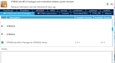

@MOBEJ
There is no option for x-cube-azure-H5 in middleware package to install and import. i will attach the photo
2025-02-21 2:34 AM
@manoj7 Please go to STM32Cube MCU packages and downloads the package , In fact The H5 package natively supports Azure integration.
