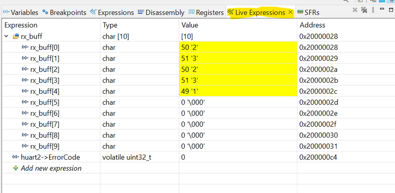

2025-03-01 9:34 AM
Use Live Expressions instead. You'll see that the data is placed in the buffer as it should. And there are no errors in the ErrorCode even after sending 123 many times
