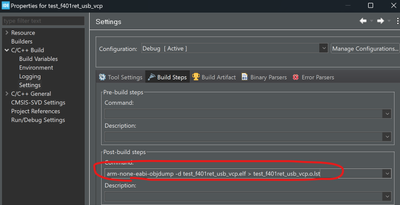

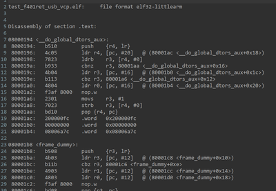

> Is there a way - after compiling but without running a debug session - to see the disassembly code after each instruction?
Add a post-build step to create the listing file:
After building, you can then open this file to view the disassembly.
