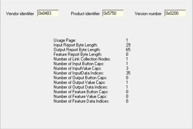

0xc0 // END_COLLECTIONUsing the USB demo tool tells me the input report byte length is 29
Now i want to crank this to the maximum which according to my knowledge is 64 bytes.
If i change the report count in the following line to 35 that should make a input report byte length of 64 in total.
