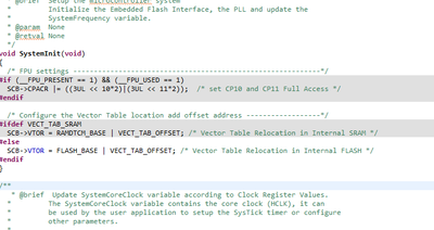

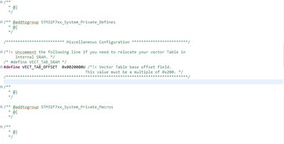

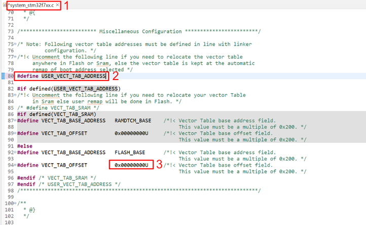

2025-02-25 11:23 PM
2025-02-25 11:31 PM
Thank you for your valuable reply, but the changes have already been made and tested.
