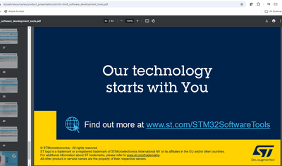

I am planning to use STM32H5 series uController in one of our test card application, as part of it i am exploring different software offerings avaialble for that series.
In doc, Embedded software solutions ST, 3rd parties and Open source (stm32-stm8_software_development_tools.pdf) page no8, has list of software solutions and list of MCU families where support is available.
There is no H5 listed here.
How i know Standard Peripheral libray, HAL, LL support for STM32H5 family?

You mean this: https://www.st.com/resource/en/product_presentation/stm32-stm8_software_development_tools.pdf ?
Always best to give a link, so we know exactly what you're talking about!
That's clearly just the slides from some marketing presentation - not a maintained document.
The website link would give you updated information:
http://www.st.com/STM32SoftwareTools
See also the 'Tools & Software' tab on the STM32H5 family page:
https://www.st.com/en/microcontrollers-microprocessors/stm32h5-series.html#tools-software
There will also be a 'Tools & Software' tab on the Product Page for each specific STM32H5 chip - that would be your starting point for all documentation & resources.
@mallik wrote:How i know Standard Peripheral libray, HAL, LL support for STM32H5 family
That would be shown on the 'Tools & Software' tab - the STM32CubeH5 package contains the HAL & LL support for STM32H5 family:
https://www.st.com/en/embedded-software/stm32cubeh5.html
The Standard Peripheral Library (SPL) was discontinued long before the H5 family appeared.

@Andrew Neil , Thanks, I got the required info. STM32 Software tools page is very good point to start with.
