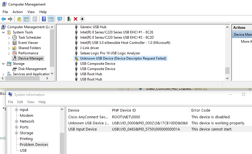

Started an example project generated by CubeMX and plugged the USB cable into the development PC. Please observe the following error. I think the report descriptor might be ill-formed: it's only 2 bytes, and ends with 0xC0 but does not begin with an 0xA101--begin application collection). Did anyone have success connecting this FW example to a Windows PC?

Unless the custom HID example's report descriptor was changed recently, I believe the problem I am noticing will appear on any version of OS (not just Windows)--just 2 bytes for the HID report descriptor just seems wrong. I cannot find any example of ending a collection (0xC0) without having begun it. The USB Complete, 4th Edition certainly does not do it that way, and I have not yet found any example on the web that suggests that the 2 byte HID report descriptor (0x00, 0xC0) will enumerate. Please correct me if I am wrong.We’re moving the ST Community to a new platform to give you a better and more reliable community experience.
