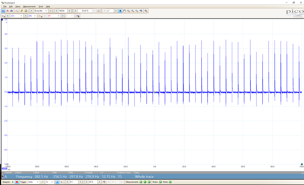

I'm running into similar problems. The clock tree looks Ok, equal to the capture.png but PLLM=16 and PLLN=360.
It looks like it resets itself, I don't know why I see this erratic behaviour at the LED output. I attached a picture to reflect what I'm seeing. During those shurt toggling moments it toggles at roughly 6.7MHz.
Any Idea what could be causing this?
