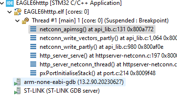

2024-09-24 8:15 AM - edited 2024-09-24 8:40 AM
Looking at httpserver-netconn.c, I see that the netconn_write() never exits.
At the first call
else if((strncmp(buf, "GET /STM32F4xx.html", 19) == 0)||(strncmp(buf, "GET / ", 6) == 0))
/* Load STM32F4xx page */
fs_open(&file, "/STM32F4xx.html");
netconn_write(conn, (const unsigned char*)(file.data), (size_t)file.len, NETCONN_NOCOPY);
fs_close(&file);
necconn_write() does not exits since it is blocked by the semphore in api_lib.c
static err_t
netconn_apimsg(tcpip_callback_fn fn, struct api_msg *apimsg)
err_t err;
#ifdef LWIP_DEBUG
/* catch functions that don't set err */
apimsg->err = ERR_VAL;
#endif /* LWIP_DEBUG */
#if LWIP_NETCONN_SEM_PER_THREAD
apimsg->op_completed_sem = LWIP_NETCONN_THREAD_SEM_GET();
#endif /* LWIP_NETCONN_SEM_PER_THREAD */
err = tcpip_send_msg_wait_sem(fn, apimsg, LWIP_API_MSG_SEM(apimsg));
if (err == ERR_OK) {
return apimsg->err;
return err;
There are two calls to netconn_apimsg(). The first exits:
the second is blocked by
tcpip_send_msg_wait_sem()
This is the problem but the mechanism according which these semaphores are managed is still obscure to me.

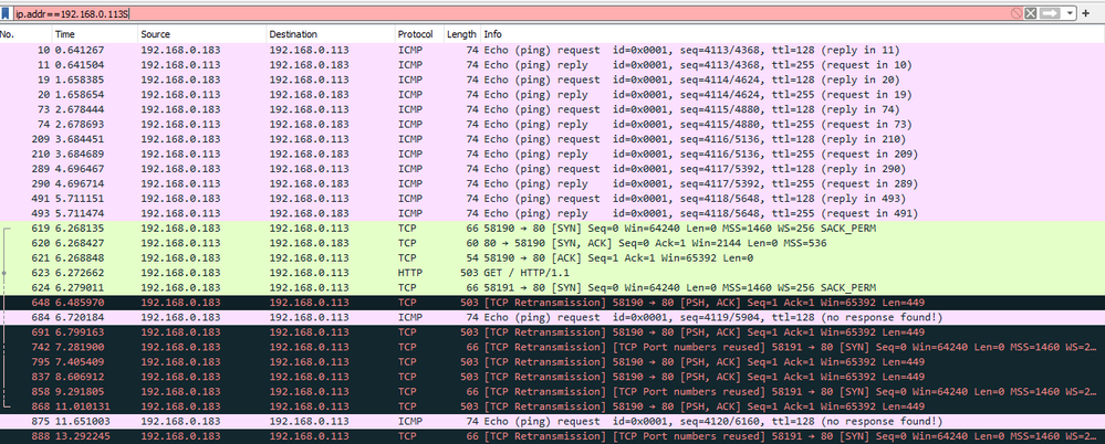

2024-09-25 2:39 AM - edited 2024-09-25 5:13 AM
Looking at wireshark capture I get this kind of packets.
The LwIP blocks in netconn_write call for the semaphore issue as stated above.
fs_open(&file, "/404.html");
fs_close(&file);
Thank you.

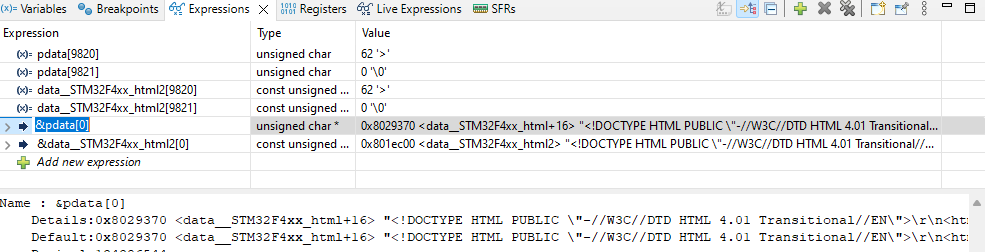

2024-09-26 3:35 AM
Hello.
It seems that the problem is in reading the page from fsdata.c.When I copy the page source as a static variable as below it works:
static const unsigned int dummy_align__STM32F4xx_html = 4;
static const unsigned char data__STM32F4xx_html[] = {
/* /STM32F4xx.html (16 chars) */
//0x2f,0x53,0x54,0x4d,0x33,0x32,0x46,0x34,0x78,0x78,0x2e,0x68,0x74,0x6d,0x6c,0x00,
/* raw file data (9821 bytes) */
0x3c,0x21,0x44,0x4f,0x43,0x54,0x59,0x50,0x45,0x20,0x48,0x54,0x4d,0x4c,0x20,0x50,
0x55,0x42,0x4c,0x49,0x43,0x20,0x22,0x2d,0x2f,0x2f,0x57,0x33,0x43,0x2f,0x2f,0x44,
0x54,0x44,0x20,0x48,0x54,0x4d,0x4c,0x20,0x34,0x2e,0x30,0x31,0x20,0x54,0x72,0x61,
len = strlen((char*)data__STM32F4xx_html);
pdata = data__STM32F4xx_html;
netconn_write(conn, pdata, len, NETCONN_COPY);
On the other hand when reading from fsdata.c, netconn_write() hangs:
len = file.len;
pdata = file.data;
netconn_write(conn, (const unsigned char*)pdata, len, NETCONN_NOCOPY);
fs_close(&file);Comparing the two cases the length (len) is the same and the content of the pdata array is the same.
Both the arrays are in the .rodata section (0x0801EA6C in the first case 0x08026BFC in the second case).

2024-09-26 8:01 AM
Hello STea,
thank you for your reply.
I ordered a NUCLEO F439 but I am pretty sure your code will work.
But I have to start the production with our board.
I have found the point which cause the issue.
When I include the page inside httpserver-netconn.c
static const unsigned char data__STM32F4xx_html2[] = {
len = strlen((char*)data__STM32F4xx_html2);
pdata = data__STM32F4xx_html2;
netconn_write(conn, pdata, len, NETCONN_COPY);everything works.
When I take the same page from fsdata.c, netconn_write() blocks.
I tried to map both the local defined page (data__STM32F4xx_html2) and the fsdata.c defined page in the same flash section but the problem remains.
This is very obscure. In the call to netcon_write() I see that only the pdata address changes, but from the same flash section (0x0801E000 + offsett). The length is the same and teh content is the same:
I tried also to directly use the flash address:
len = 9821;
pdata = 0x080A80A0;
netconn_write(conn, pdata, len, NETCONN_NOCOPY);
Again, when using the address of the locally defined page it works, when using the fsdata.c address it fails.
To resume, in the code below, A works, B does not work. B is taken from fsdata.c while A from a local define array. Both A and B are in the same flash section.
