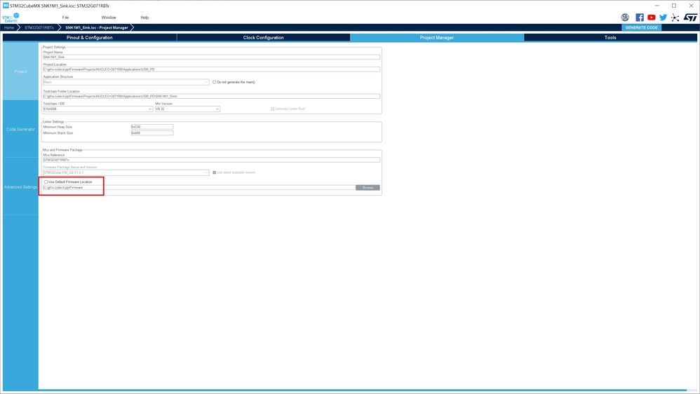

2021-03-24 11:47 PM
Hi @NathanWolcott
This package is not part of the X-CUBE package downloaded directly through CubeMX.
You should open directly IOC files provided in each USB-PD application like:
When you open it CubeMX, you should see that it is linked to your package you uploader on your laptop like this:
Regards,
