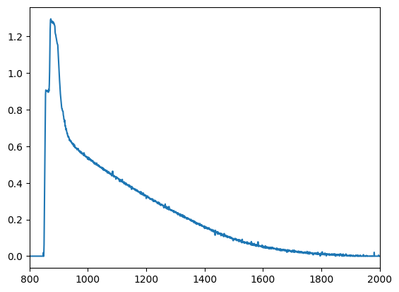

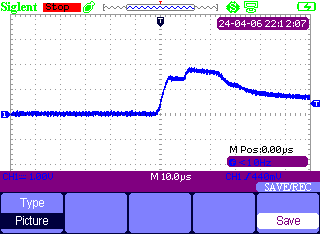

4. [Details] I am trying to measure a fast pulse with the ADC (~3 us rise time). I would like to trip a comparator when the pulse starts to rise and then start an ADC (paced by a timer) to fill a buffer via DMA. After the buffer is full, I will send the data over UART for analysis.
The COMP and ADC are both connected to the same input. The COMP is set to trigger when the voltage exceeds that of an external input set to 0.04 volts. The ADC is connected to a timer that triggers at 2 Mhz.

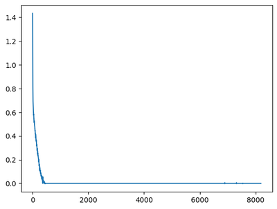

5. [Problem and Expected behavior] I have configured the above but I am seeing that the first ADC reading starts well after the pulse has started. Should I expect the time to start the ADC from a COMP to be this slow? I would like to measure the peak voltage which means that I need to capture at least some of the rising edge of the pulse.
6. [How to reproduce] I have attached the project files. Please see the attached oscilloscope view of the pulse and the plot of the ADC buffer values.

I tried starting the ADC directly with the COMP interrupt by configuring the ADC timer to start when the COMP interrupt fired. I saw a minor improvement but still too slow. The rising edge of the signal is very fast!
I then started continuous ADC conversions as you suggested. When the COMP triggers, I start a timer to wait a bit to capture the falling edge of the signal. Then I process the signal. This works well and suits my needs!
