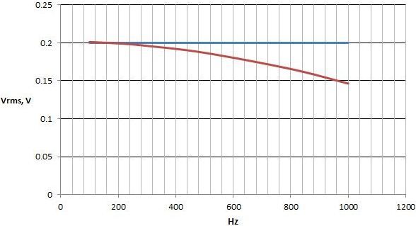

There I show you the results. Blue line is measured with AC voltmeter. Red line is my measurements with FFT library. Sampling rate 4096 Hz, number of samples – 4096. By the way, the frequency is measured with some error. 100 Hz is defined as 101Hz, 800 Hz – as 808Hz. But this doesn't confuse me much.

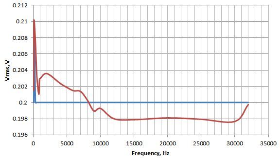

Here there're some results of magnitude calculation via a wide frequency range with voltage level 0,2Vrms. Blue line is measured with AC voltmeter. Red line is my measurements with FFT library. Number of samples – 4096 and sampling rate differs for special frequency sub-ranges. It is 4096 Hz for F=(30…1024)Hz, 20480 Hz for F=(1024…4096)Hz, 40960 Hz for F=(4096…8192)Hz and 81920 Hz for F=(8192…32000)Hz. As you see, the results are very satisfying.
