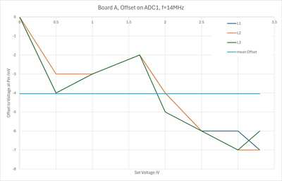

I then started seeing more of that behavior with other ADCs and their respective channels. There was always some offset in the measurement. To be able to quantify the offset, I ran a test, where i applied a dc voltage to the other channels, measured the voltage at the pin and compared it to the ADC values. (see attachment meas offset.png). I had very similar behavior on several boards.

to test, I left out the calibration and it did have an effect. Instead of 3.182V Vref+ calculated from Vrefint, I now had 3.387V. There is a similar behavior over the measuring series as bevor, but with an added offset. That is expected afaik, the calibration only accounts for the factory offset, no gain adjustments. See attached graphs. Note that I changed fADC and sampling time additionally. From 42MHz 24.5 cycles to 14.2MHz 247.5 cycles for testing. The out of spec offset at @ 1V remains.
On that point, the calibration seems to correct the ADCs value from 65 to 100 points on ADC1. With less pronounced changes on ADC2.
Difference in the ground potential should not be an issue since in these measurements the internal OPAMP are used as signal source in a standalone configuration. For the measurement I compared its output to the ADC, so any influence will not be present. The line to the ADCs input is pretty long thought, so adding a capacitor or increasing sampling time helps compensate this issue.
@MasterT
Thanks for your input. The capacitors and differential mode are both viable considerations we look into for the next iteration. For now, lowering the frequency also helped. The values for each channel on ADC1 are closer to each other (except at the problematic 1V measuring range).
BR
In my latest measurement series I had a bug with the initialization of the ADCs, especially the clock division in the common ADC structure and didn't set the division for ADC1 and ADC2.
Fixing that solves the issue of the offset! I ran each channel on the ADC1 from 24.5 to 247.5 cycles, which doesn't have an effect. So its not really the sampling time, but the silicon around the SAR that benefits from the lower clock.
Thanks for your help.
