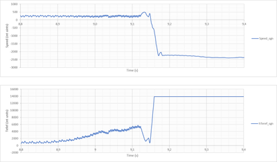

I am testing motor control and tuning PID constants. When I apply some braking torque to the output shaft, sometimes the motor starts rotating in the opposite direction at full speed, and it stays there.
I have experienced the same with v6.3.2
It doesn't seem to be related to control constants.
It looks like it has happened before in this forum (link) and it doesn't look like it was fixed.
The plot with the reference and actual speed is attached.
Has anybody experienced this before?

I can reproduce the direction shift and capture data. Torque reference doesn't seem to flip, maybe it's the rotor position estimation that changes and a positive torque reference turns the motor in the opposite direction.
Al least, as speed is correctly identified, it should be possible to trigger a "Speed Feedback" error similar to when the speed gets too low

In the first attached picture, the issue occurs immediately after the starting point.
Does the issue only occur at this point? If yes, did you apply the braking torque during the SWITCH_OVER state?
If the RUN state is achieved when a negative speed occurs, the firmware must report a SPEED FDBK error. As this is not the case, the issue might originate from error detection. In this scenario, replace the following lines in the speed_pos_fdbk.h file.

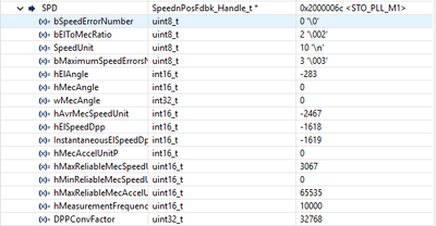

Sorry for the late reply, but I'm having issues checking that solution. I had some mechanical issues with the motor and, when I fixed them, the mechanical play was removed and it's more complicated to replicate the error.
The issue didn't seem to be related with bSpeedErrorNumber, this is a screen capture I took while the motor was running full speed in the wrong direction a couple weeks ago:
You can see that bSpeedErrorNumber is 0.
Anyway, in the new mechanical setup I've only been able to reproduce the error at very specific conditions (forcing PWM frequency to 160kHz and lowering a lot control constants), and the code modification didn't detect that either.
I'm afraid that, with a different mechanical configuration or observer constants, the motor starts spinning in the wrong direction.
I also confirmed that, during RUN, if the motor is running backwards, there is not SPEED FDBK error reported. I'll take a look at modifying that, as it should at least be a protection against this failure.
