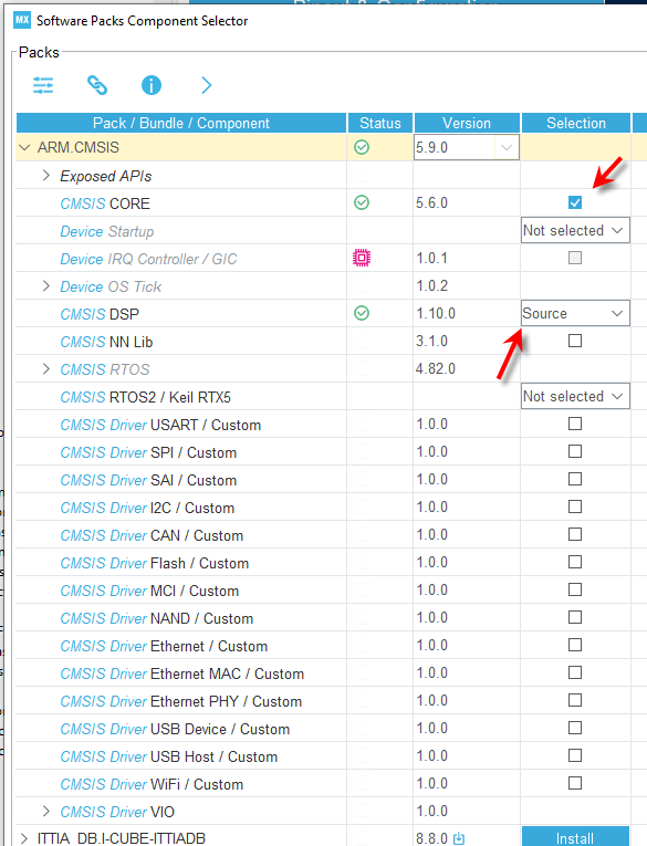

I just started a new project and wanted to use CMSIS 5.9 - as it finally can be installed from the package without errors.
Until now I only used CMSIS 5.7 als library, which worked pretty well. Unfortunately since 5.9 there is no library availiable, which could be included so I had to select "source" in the CubeMX Setup:
CubeMX CMSIS Setup
The only difference to CMSIS 5.7 as I used it previously is, that I selected "source" for the DSP component and of course the version 5.9

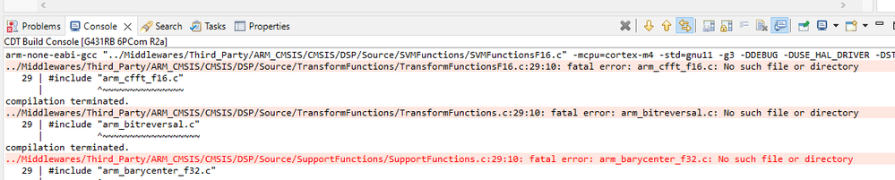

I wrote a simple test programm and tried to compile it. The result is a lot of missing dependencies:
console output
it is e.g. complaining about:
./Middlewares/Third_Party/ARM_CMSIS/CMSIS/DSP/Source/SupportFunctions/SupportFunctions.c:29:10: fatal error: arm_barycenter_f32.c: No such file or directory or
../Middlewares/Third_Party/ARM_CMSIS/CMSIS/DSP/Source/SupportFunctions/SupportFunctionsF16.c:29:10: fatal error: arm_copy_f16.c: No such file or directory

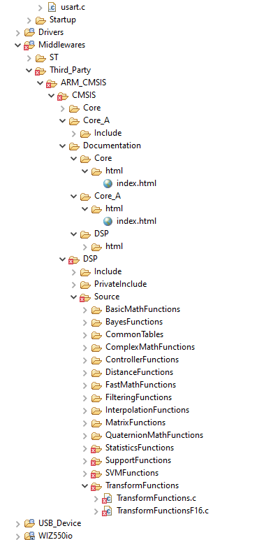

project tree

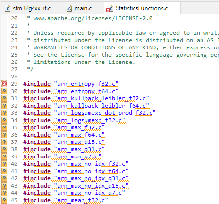

if I open one of these files, it is just the tip of the iceberg, there are lots of missing dependencies:
StatisticsFunctions.c e.g. wants to include lots of *.c files, which are non existant in the project.
