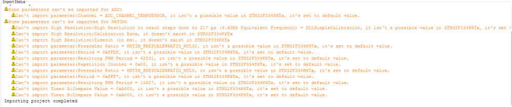

Hi again - I tried with the new version V4.22 and found it still cannot import my project without errors.
I get these errors when I try to import a project TO AN IDENTICAL MCU!
Some parameters can't be imported for ADC1
Can't import parameter:Channel = ADC_CHANNEL_TEMPSENSOR, it isn't a possible value in STM32F334K4Tx, it's set to default value. Some parameters can't be imported for HRTIM1 Can't import High Resolution:High Resolution to reach steps down to 217 ps (4.6GHz Equivalent Frequency) = DLLSimpleCalibration, it isn't a possible value in STM32F334K4Tx, it's set to default value. Can't import High Resolution:Calibration Rate, it doesn't exist in STM32F334K4Tx Can't import High Resolution:Timeout (in ms), it doesn't exist in STM32F334K4Tx2017-07-13 8:57 AM
