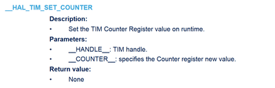

2024-07-25 10:36 AM
there are some API is of the type
you may refer to the HAL documentation for the specific Family you are using.
