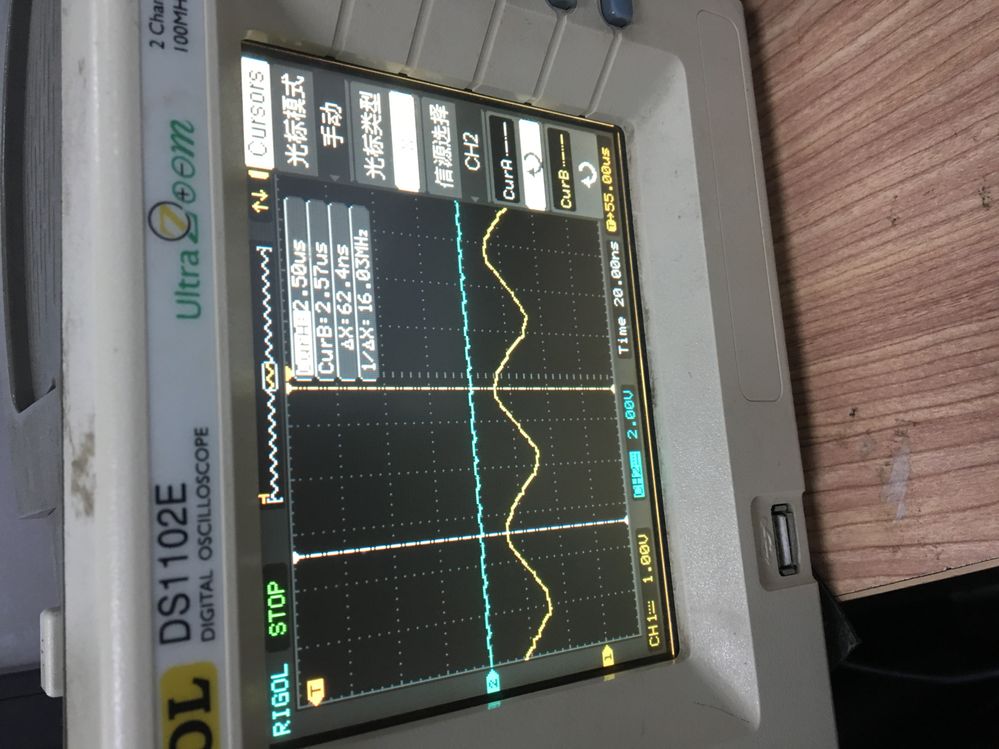

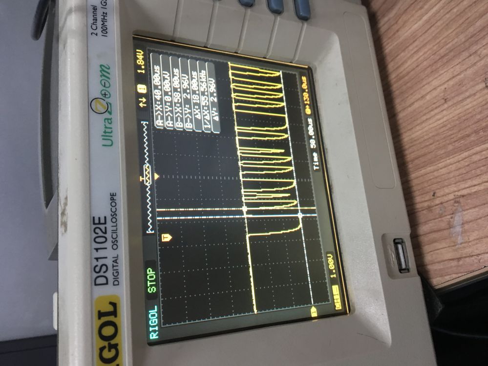

Which part of board should I check? Attach are my check for HSE and D+ frequncy with oscilloscope. Please have a check.

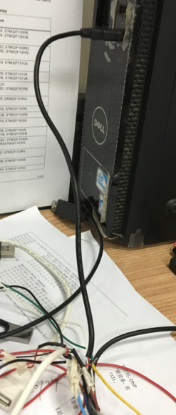

This is my used USB line. I use our product to do the function. USB D+/D-> device D-/D+, USB GND->device GND, USB power -> device VBUS.
I have no nucleo board and any other EVAL board. I will try my best to get one and confirm again. Thank you very much.
