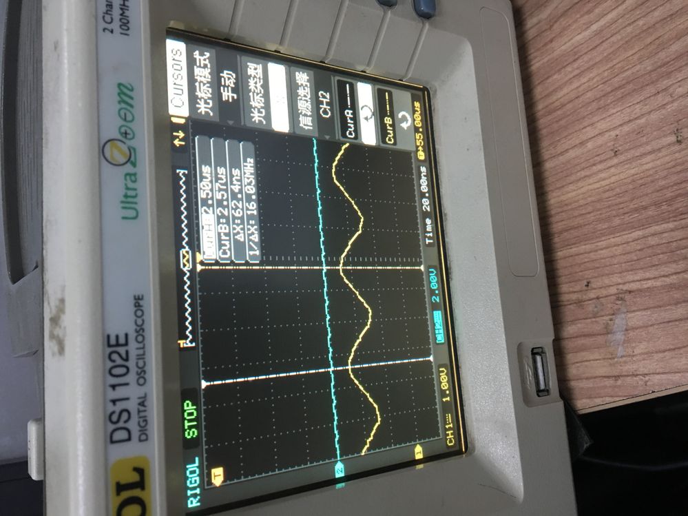

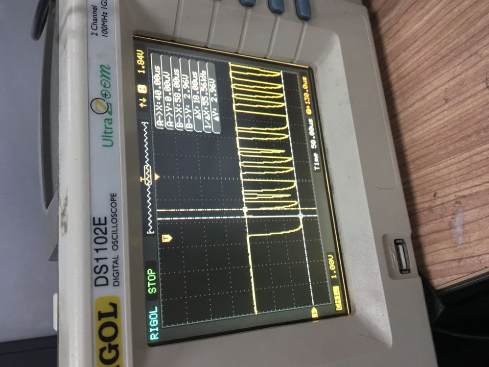

please check your crystal is running with a scope, do you have one ?
please check that inside the cube the crystal is connected to the PLL and running the system clock and the USB port.
I am sure this is the problem, since it half works, just like mine did.
2019-07-17 4:51 AM
Sorry that I don't understand your meaning clearly. I check the HSE and USB D+ frequency. Please have a check.

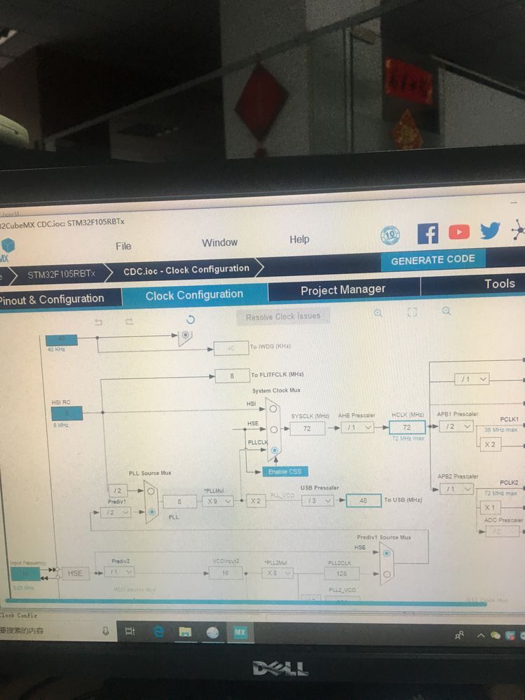

I assume 16 MHz external should work, if the rest of the clock setup is ok (the clock setup page should tell you so).
The F103 is different from F105, in that it doesn't have the USB OTG support. So there were some slight differences in the generated code, but I'm assuming you haven't touched the generated code, so should be fine for F105.

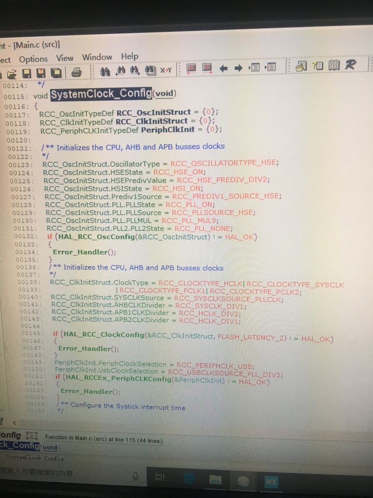

Attach are my clock setting.
