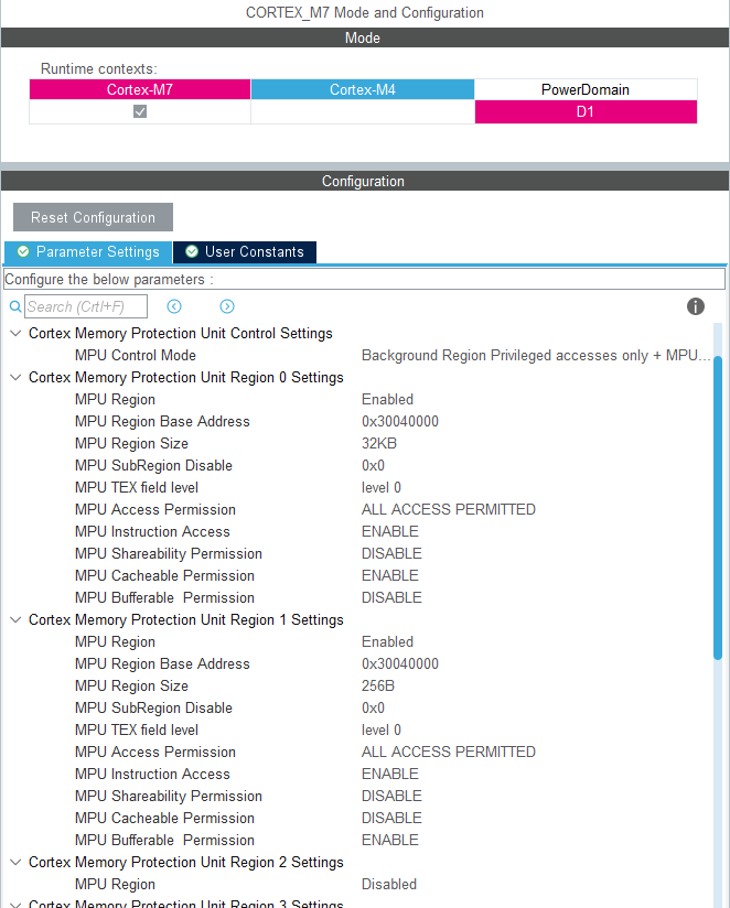

Change Timebase to TIM6
Setup the MPU and enable D and I Cache

If I try using freertos and LWIP then it all works suggesting that link to board and PC are fine.
Can you please suggest if I am missing anything.
