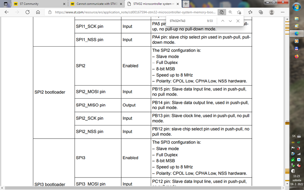

You need handle initial interface selection , maybe your code dont meet this read AN2606

To the best of my knowledge, I am complying with AN2606, see CubeMX settings:
I'm not using the NSS directly from SPI because, using a logic analyzer, we found that chip select [NSS] was remaining asserted [low] after the buffer had been transferred.
So we disabled direct NSS and wired GPIO to PB12 and it works fine, when my own firmware is running in the SPI slave but not when the STM Bootloader is running.
