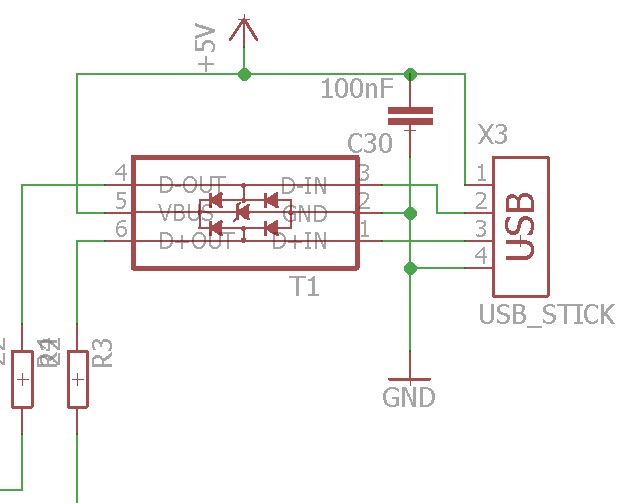

My cutom device, powered by STM32F429ZI, has two USB ports. Each one is connected via USBLC6-2 (ESD protection) chip to MCU (USB FS and USB HS) pins. VBUS is not used.

If I configure both - FS & HS as mass storage devices (host only) then the only one USB stick is initialized (and can be accessed vis FATFS). The second USB stick remains in HOST_IDLE status all the time. I tried swapping sticks and changing USBH instances. Nothing helps.
