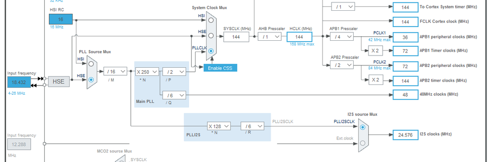

2020-11-15 4:02 AM
The best helper for this is this:
