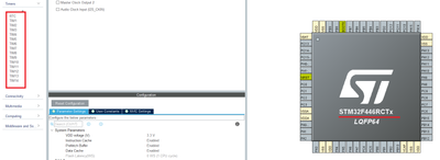

Hello, i am using F446 and i am contemplating using FreeRTOS CMSIS V2 software timer to generate PWM to control motors via motor drivers (IC chipset). Is this possible? Or must I use the hardware timer, TIM1~7 ?
2026-04-30 1:51 AM
As said by @Andrew Neil ,
There are 14 timers in STM32F446:
You are using half of timers resources in your case only 1 to 7 in your case.. So why bothering yourself with the software timer usage?
2026-04-30 4:35 AM
Hi there, i got total 63 motors to control. F446 has 14 timer, TIM6 and TIM7 is a general timer, does not have CCR and AAR registers, so cant use for PWM.
