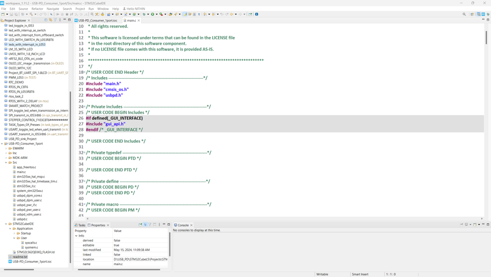

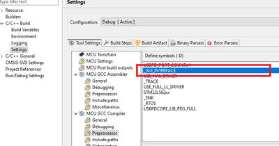

That's strange.
If you go to the Preprocessor menu, you need to find the flag _GUI_INTERFACE:
I've cloned the project and the define is there.. could you please check in your Preprocessor config?

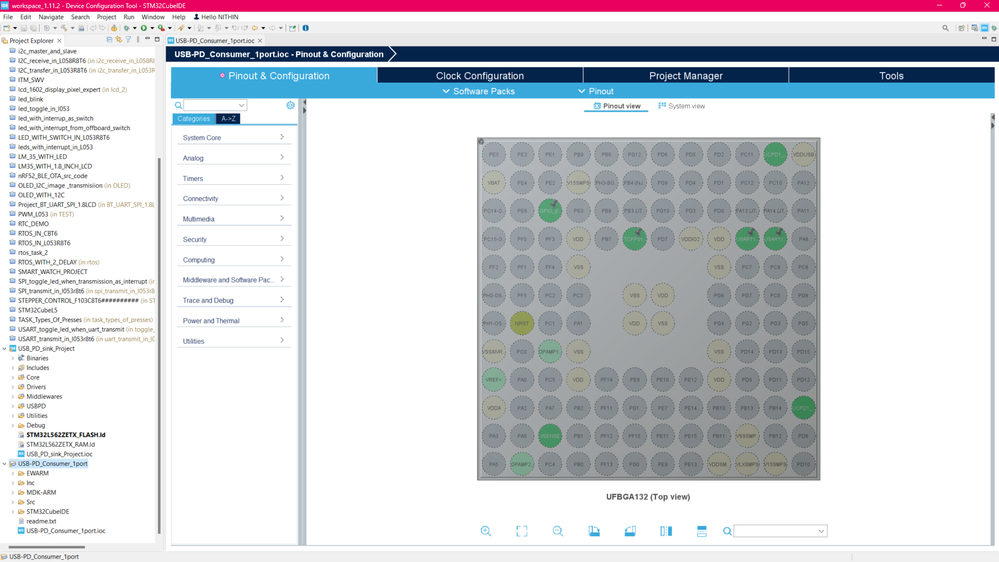

Hi @Nicolas P. , @Peter BENSCH , @mƎALLEm ,
I've cloned this repository using recursive option and i directly imported the project file "USB-PD_Consumer_1port" only , from "D:\USB_PD\project_1\STM32CubeL5\Projects\STM32L562E-DK\Applications\USB-PD\USB-PD_Consumer_1port"
but i can't build the project ,as the build option is disabled, but I'm able to build other projects in my ide.
other projects are opening as stm32 project and this one is opening as just a file system, is that the reason?

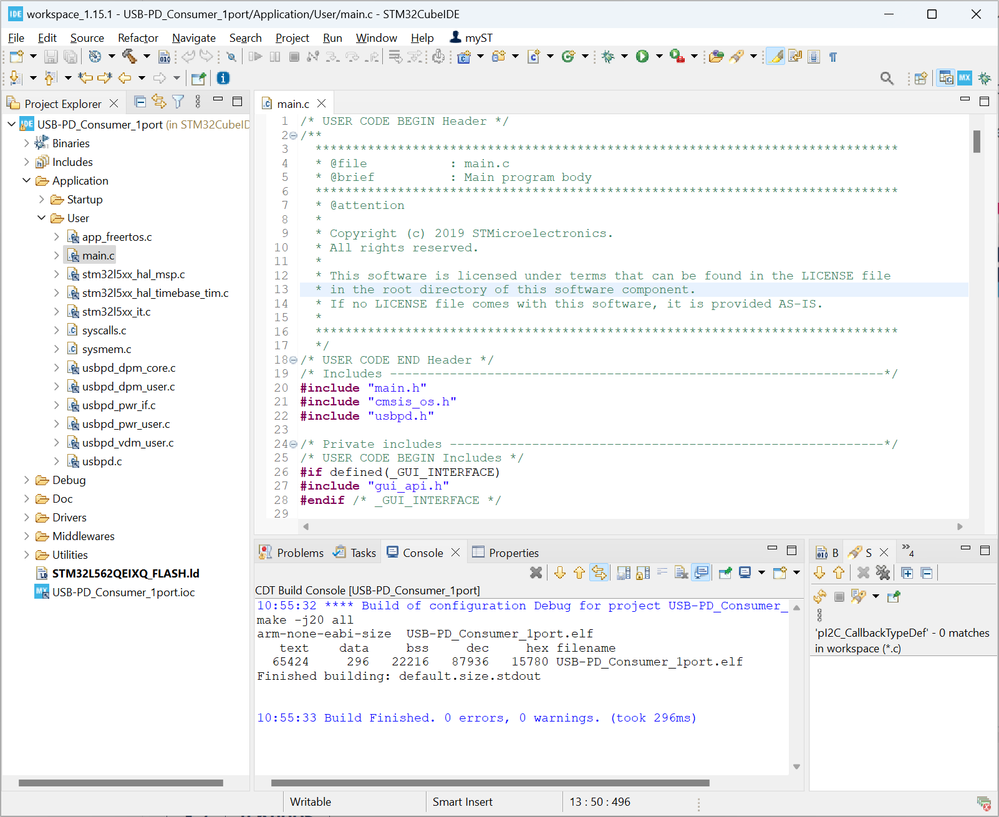

Hello @NITHIN
From the picture it seems you opened the .ioc file. Am I right ?
We wouldn't see the EWARM, MDK-ARM directories because useless when using CubeIDE.
I'm using CubeIDE 1.15.1, and opening the file : STM32CubeL5\Projects\STM32L562E-DK\Applications\USB-PD\USB-PD_Consumer_1port\STM32CubeIDE\.cproject opens the project without issue.
I have no issue compiling too.
