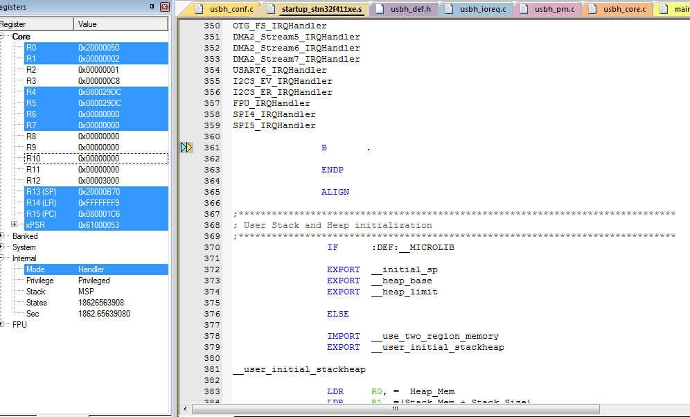

. As I plug it, my program is stuck here :GPIO_InitStruct.Pin = (GPIO_PIN_11 | GPIO_PIN_12);
GPIO_InitStruct.Speed = GPIO_SPEED_HIGH;
GPIO_InitStruct.Alternate = GPIO_AF10_OTG_FS;
GPIO_InitStruct.Pin = GPIO_PIN_6;
HAL_GPIO_Init(GPIOA, &GPIO_InitStruct); Then I set PA6 to have 3.3V.

> Has Anyone a idea about this ?
Looks like an exception handler gets called that has just a default implementation and that default implementation is just an endless loop.2016-04-04 3:05 AM
