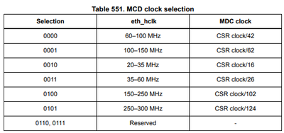

The code in HAL_ETH_SetMDIOClockRange() function for H7 series, starting from HCLK frequency of 150 MHz and higher, sets the MDIO clock divider to 102. Per IEEE 802.3 specification the MDIO clock must not exceed 2,5 MHz, which means that it will be valid for HCLK up to 2,5 MHz * 102 = 255 MHz. But for H72x/H73x parts the maximum AHB frequency is 275 MHz and for H7Ax/H7Bx parts 280 MHz. Obviously the solution is to add a range with a divider 124, which will be valid up to 2,5 MHz * 124 = 310 MHz. The code for H5 series is correct, although ironically the maximum HCLK speed for those MCUs is 250 MHz anyway. Also the comment on the line 2405 incorrectly mentions 200 MHz instead of 250 MHz.
In addition for HCLK frequencies below 20 MHz the code sets the divider to the highest value, which is the worst possible one. Instead it should set it to the appropriate or lowest possible value. For Fx series that means setting the divider to 16, but for Hx series the divider can be as low as 4. While very low HCLK frequencies are not appropriate for MAC operation, they are still valid for MDIO operation and PHY configuration, which could be useful for some projects.

Good find, thanks for posting. Immediately checked my code and found that I'm using the highest divider ETH_MACMDIOAR_CR_DIV124. :D

Why's that "damaging"? With the divider of 16, MDIO clock is set to 1.25 MHz, that a problem?

It's damaging for HCLK frequencies below 20 MHz, because it sets the highest divider, which results in unnecessarily low MDIO frequencies. Read the second paragraph of the main post. :)

I confirm that the STM32H7 ETH driver shall be fixed for the MDIO clocks range. We missed the update in the latest version and it will be done in next release. (files enclosed).

Regarding the 20MHz frequency: it is not clear to me, because I think that frequencies below 20MHz should not be supported. But I need to check then get back with a confirmation.
But could you please explain why you think that all the other conditions are useless/bloat ?
Regarding the If/Else layout and coverage, the rationale is keeping the code easily readable and understandable and to align it with reference manual description. So it shall be generic (covering all derivatives of the same series) and simple to read.

My main post explains why the (hclk >= 20000000U) condition is harmful regardless of the specific hardware requirements. Apparently you didn't read it. It also explains for what purpose the low HCLK frequencies are still useful. Again you didn't read it. The DIV102 range in your "fixed" files still contain the wrong comment about 200 MHz upper limit. And again you didn't read my post. In addition, calculating the DIV124 range with your suboptimal undocumented formula, gives the upper limit of 305 MHz, not 300 MHz. But, of course, for some geniuses the "better looking" numbers are more important than actual engineering or even just a basic consistency.
