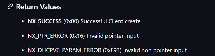

NX_SUCCESS (0x00) Successful Client create
NX_PTR_ERROR (0x16) Invalid pointer input
NX_DHCPV6_PARAM_ERROR (0xE93) Invalid non pointer input

2025-01-27 1:46 AM - edited 2025-01-27 1:50 AM
Hello @mbarg.1 ,
Just wanted to point out that as per the NetX documentation in GitHub implies:
"In the "Return Values" section in the following API descriptions, values in BOLD are not affected by the NX_DISABLE_ERROR_CHECKING define that is used to disable API error checking, while non-bold values are completely disabled."
and since only NX_SUCCESS is in bold and other return values are not those two are completely disabled.
just wanted to know how you are passing the uninitialized pointer to this function and are you sure NX_DISABLE_ERROR_CHECKING is not activated?
also, I want to point to you that issues related to Nextduo documentation should be input in Issues · eclipse-threadx/netxduo
Regards

2025-01-27 6:05 AM
Hello @mbarg.1 ,
This seems to be valid to me if the pointer is declared and uninitialized this will return success assuming that the pointer was declared with value different than NULL so I suggest that you declare the pointer to a NULL value, and it should then catch the error and as suggested before this should be input in Issues · eclipse-threadx/netxduo as this is not ST documentation and source code but eclipses open-source code.
Regards
2025-01-27 7:46 AM
Sorry, but i do not agree.
A function must return NX_SUCCESS when it performs what is intended to do, some ERROR otherwise.
I our case, function is intended to send a packet and if packet cannot be sent, MUST return ERROR, not NX_SUCCESS.
I agree that the problem involves Eclipse ThreadX but STM is partecipating to this project, not me; is up to you to lobby for bug resolution, or edit code / manuals before using in libraries in your IDE.
Discussions with STM officials did agree on that, so far.
2025-01-31 6:00 AM
Hello @mbarg.1 ,
I'm reporting the issue internally (ticket number 201985 for internal reference only) to AZRTOS experts. When you said, "Discussions with STM officials did agree on that, so far.", do you mean that you are discussing same issue with other colleagues who confirmed it?
Regards
2025-02-01 4:22 AM
Yes, STM people that I met @tradeshows and other venues.
