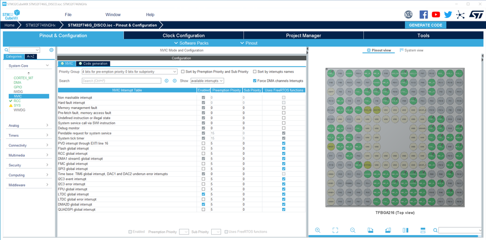

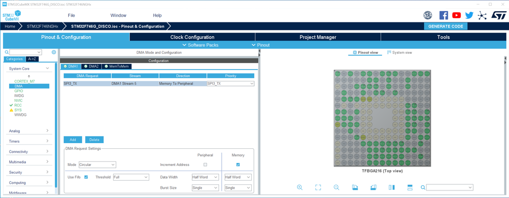

only guessed : the "right" priorities are critical ! so try ...in nvic and dma settings.

Many thanks for the answer! Unfortunately I don't really know what you mean by that. I attached two Screenshots from CubeMX for the "DMA" and "NVIC" sections.

maybe something with priorities, see: if you start something (maybe : play) and this function use INT or callback , but here some other function (maybe, read data from USB) is called and this waits for an INT on same or lower priority level, it can never get this INT and "freezes" in this waiting state. but if priority higher, INT will come and finish (whatever it should do) and your function works and goes on.

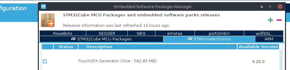

but you can select it in IDE -> software packs
and from https://www.st.com/en/development-tools/touchgfxdesigner.html ->
should work in IDE... read:
+ howto...

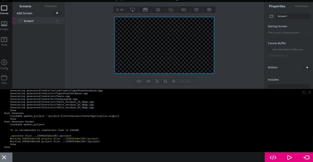

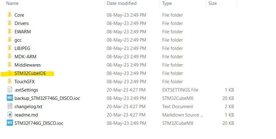

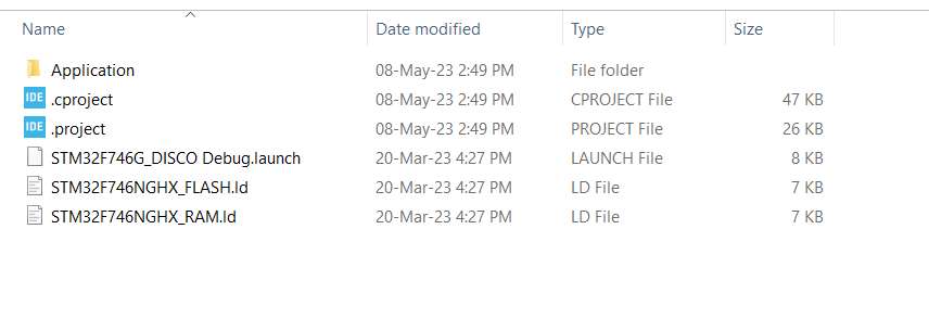

For example: I created a new project in TouchGFX Designer for my STM32F746-DISCO board. Since I want to test Audio output, I opened the auto-generated CubeIDE project and added some c and h files for the audio output. But the "Core" and "Drivers" folder exists twice, once inside and once outside the CubeIDE project folder. But some of the files need to be in one, and some in the other folder.
I even opened a thread here for that issue specifically (https://community.st.com/s/question/0D53W00002Cj4OCSAZ/how-to-setup-project-for-touchgfx-and-audio-output), but got no answes - apart from the obligatory "just look at the examples".
