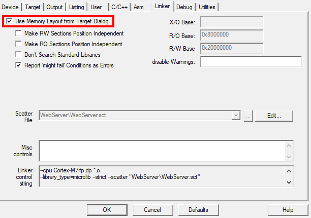

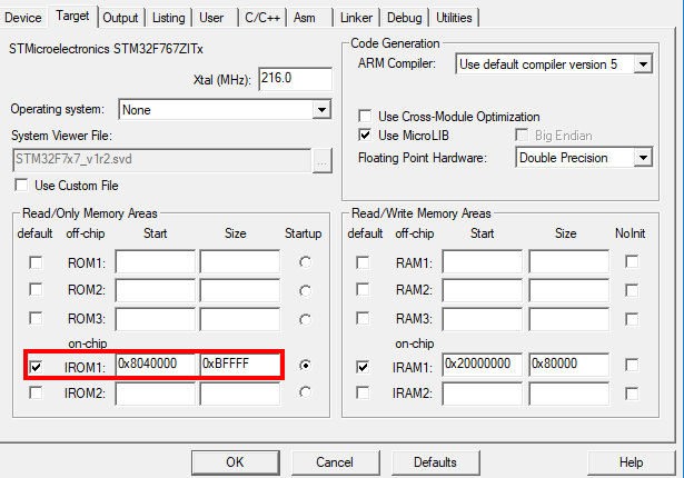

2019-07-20 5:18 AM
Hello, thank you for your answer !
I do not know if "Linker" means the start address of the app, but if it does, I'm good. What I do not understand is that normally with a wrong starting address, no matter the application it would not work. So I must be wrong.
I use Keil as programming software. To change the starting address of the application, I modify the position of IROM1 and the size.
In any case what you tell me is interesting, I may be a small mistake from the beginning. Thank you
2019-07-20 5:47 AM
The GUI settings build you a scatter file (linker script) doing what you need.
The Size here is a total, not an end point, so 0xC0000 is more appropriate than 0xBFFFF
