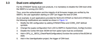

2025-11-25 2:16 AM
Hello @RahulPatel
Please refer to the Integration guide for the X-CUBE-SBSFU STM32Cube Expansion Package.
In the integration guide for STM32H7 dual-core products (Section 3.3), it is stated that the CM4 boot must be disabled while SBSFU is running on CM7, and the CM7 application can trigger the CM4 boot after authentication and integrity checks are completed.
