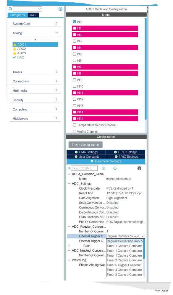

2021-10-17 11:19 PM
Looks like for my board the only option I get in CubeMX under ADC "External Trigger Conversion Source" is EXTI Line 11 (doesn't give me any option to set the source to a timer)
2021-10-17 11:36 PM
should look like this (for the nucleo board), see also chip reference manual:
hth
KnarfB
2021-10-17 11:41 PM
Not sure what I changed, but now I'm seeing the same as your screenshot. All is good!
