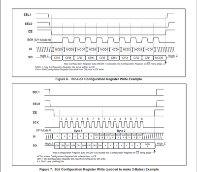

I need to communicate with a component whose configuration register expects a 9-bit value. However, my current SPI setup sends data in 8-bit chunks.
In this case, what would be the correct approach? Should I send two bytes back-to-back? Or would it be better to make this configurable in main.c so that the behavior can be adjusted easily?
If you were in my place, how would you handle this?

I only need to send a 9-bit configuration value once during initialization. After that, all read/write operations will use standard 8-bit communication.
2025-09-10 6:17 AM
I've found the answer :)
