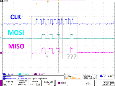

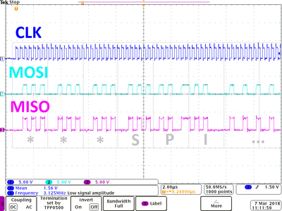

Posted on March 07, 2018 at 13:01 EDIT: 14/03/2018 https://community.st.com/people/Schwaninger.Hannes‌ found that we need to use RAM_D1 and not DTCMRAM of the memory area. This is not made by default when we use STM32CubeMx to set SPI ...
