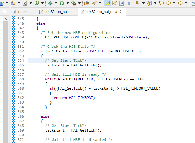

2022-06-01 6:10 AM

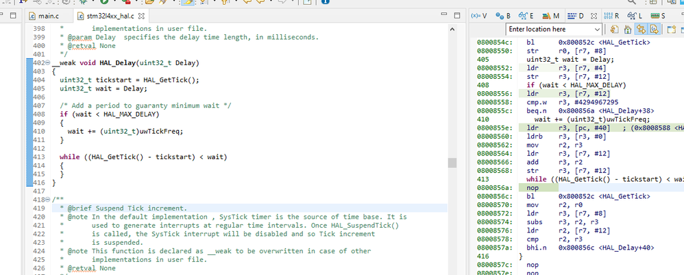

I have further debugged with this using STLink. Bootloader stucks into waiting for HSE is ready or not.
Also Debugged Led App Seperately. If I start that application from 0x8000000 it works preffect but If I change address to 0x8008000 it stucks in HAL_Delay as shown below in while

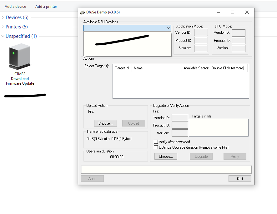

Can you please help me out here.
I have been able to detect device as STM32 DownLoad Firmware Update in my device manager. But DfuSeDemo tool is not able to detect the device(B-L475E-IOT01A). I am using STM32CubeIDE as my developement environment.

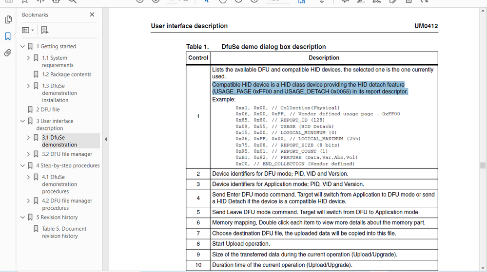

From the UM0412 User manual, It says that
Compatible HID device is a HID class device providing the HID detach feature (USAGE_PAGE 0xFF00 and USAGE_DETACH 0x0055) in its report descriptor.Can anyone guide me on how to use this ?

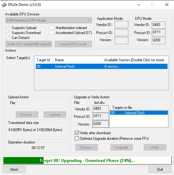

Hello guys I am able to detect the device in DfuSe Tool by installing the drivers.
Got the solution from this
But now I am getting this. It stucks at 24% everytime.

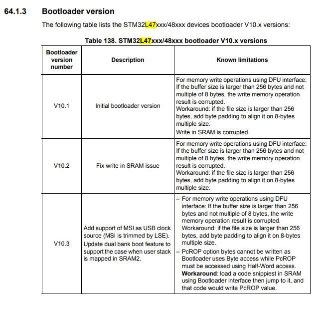

Which bootloader version is used ?
Maybe that the problem is related to the bootloader version.

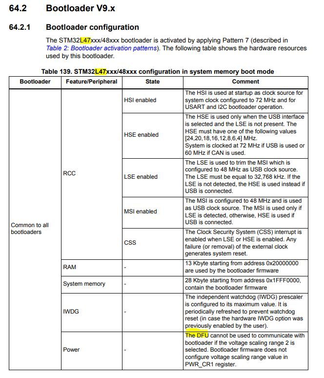

Please check your configuration with boot mode and the Known limitations described in the AN2606 related to your device and bootloader version.

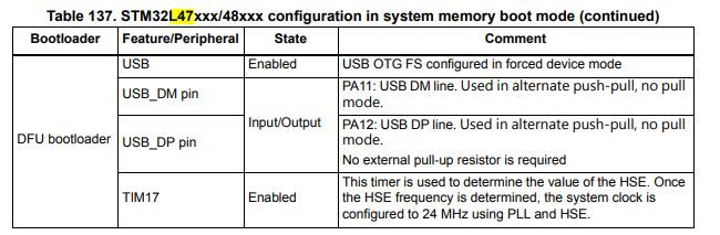

This video doesn't show any timer configuration as suggested by AN2606 - Timer 17
I couldn't found any source code for bootloader version 10.x or 9.x. Can you please provide the source ?

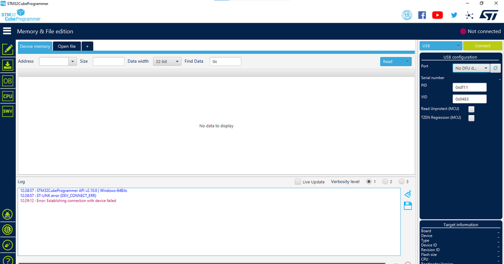

@Imen DAHMEN
I have checked with STM32CubeProgrammer. It can not detect my device as USB.

Thanks you for the response.
Now I am able to DFU on my device, but after full chip erase and bootloader flashing.
After I have done DFU once, after that I am not able to do it again. It again stucks at some random percentage. To do it again, I have to erase full chip using STMCubeProgrammer, reflash the bootloader and then I can do the DFU.
