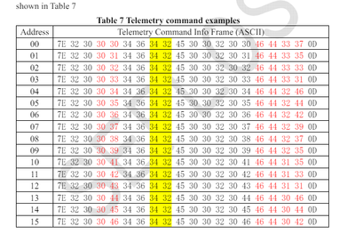

eg of query command from the datasheet
if you prefer to read in your main loop keep reading till you get 0x0D or in interrupt you can receive one byte each till you assemble all bytes till 0x0D. Then inform main loop to process the data. The response will happen if you send it to the correct address, else nil. At least one message you hand code carefully and test it.

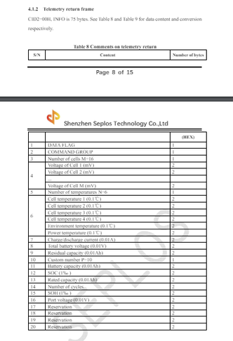

As far as I understand, the STM sends commands based on the data in Table 7. For example, after sending the telemetry data at address 00 in Table 7, we should automatically receive the parameters such as cell voltages and cell temperatures listed in Table 8, right? My main question is, if I need to store the temperature and voltage parameters from Table 8 into specific arrays, those bits should correspond to the temperature and voltage values we need. However, it is not specified in Table 8 which bytes the temperature and voltage data should be stored in. In this case, do you think my void SeplosBms_Read(); function is written correctly? Do you see any other errors in the code?

Table 8 seems clear in the sense that the how many bytes are needed for each parameters, you need to count it as per the table, first read the number of cells and based on that you can count from the start of the frame. Looks like if you read the document multiple times and analyze you can do it.

My thought about Table 8 is that it provides the necessary information about the number of bytes and how much space to allocate, but it does not give complete information on which parameter to store, for example, in the 15th byte. In this case, I made a logical inference and created the SeplosBms_Read() function accordingly, but I am not sure if it is correct
