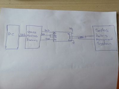

I have a SEPLOS brand battery management system card, and I want to read temperature and voltage data from this card. Initially, I will use an STM32F407VGT6 board to read data from the SEPLOS battery management system card via RS485. I am sending the commands first to get the data, but although the data is being sent, I cannot perform the reading operation. What do you think could be the reason for this problem?
The PDF I will send below contains an information sheet about how I should read data from the SEPLOS brand battery management system via RS485. Please look at the PDF and my code to see if you can find where I might be making a mistake.

Can you post your full code?
2024-06-21 9:53 AM
Good.
Connect another 485 to USB adapter on the network to a terminal program, run the SEPLOS program, then your configuration and compare to see where the disconnect is. The terminal program won't provide timing, but will show the command and response sequence. The terminal will probably have to be in HEX mode.
2024-06-21 10:04 AM
Your receive method makes no sense, it loops, has a blocking UART_Receive() of unknown length.
Loops around that 76 times, doesn't define the memory buffer's it is using in this context. Based on RxData[i] it's 76 characters long, but how is that supposed to synchronize with the data transmitted. How is the RS485 bus direction set? Presume the GPIOD are changing LEDs, but no commentary.
This is an STM32F407G-DISCO board?

Yes, I am using the STM32F407VGT6 board. I can show you the block diagram of the system as follows.
2024-06-21 11:30 AM
What I want to do is send telemetry data from the datasheet with the STM32F407VGT6 board and then read the 75-byte long temperature and voltage data. I have no issues with the data transmission process; it is successful. However, I am unable to read the data during the receiving process. Are you suggesting that using DMA to read the necessary data when the line is idle?
