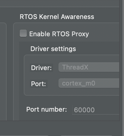

Have you enabled the "RTOS Kernel Awareness" in the debug configuration (presuming you are using CubeIDE)? This can help when stepping through tasks.These settings are on the "Debugger" Tab in the "Debug Configurations" dialog. See the CubeIDE users manual for details.
2023-05-24 5:33 PM - edited 2023-11-20 4:51 AM
I see these settings. What values do I enter?
2023-05-24 8:37 PM
Yes, that is the section. Check the "Enable RTOS Proxy" box. The "driver" options should be obvious which one to choose. And there should only be one choice for "port". If there are multiple, look for something like "cortex_m4" since you are running on an L4xx part.
