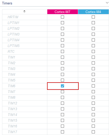

Hi @MDeva.1
you'll need to assign the TIMER to the respective Core first.
then the TIMER will be available for selection.

Hi @MDeva.1

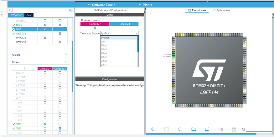

2021-12-15 7:08 AM

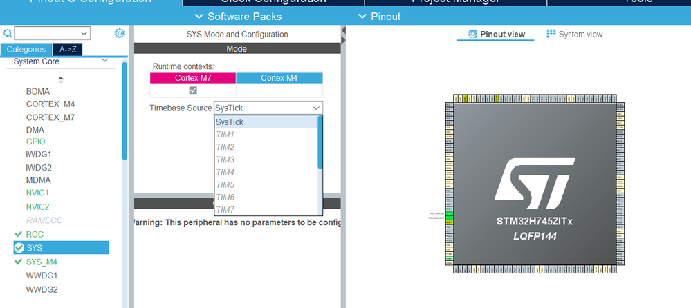

I am working on NUCLEO-H745ZIQ board. I am using the STM32CUBE IDE 1.7.0. According to you first I setup the TIMER to particular core ,after I tried to set to Timebase source but it doesnot allow me.I am sharing the snap shot.

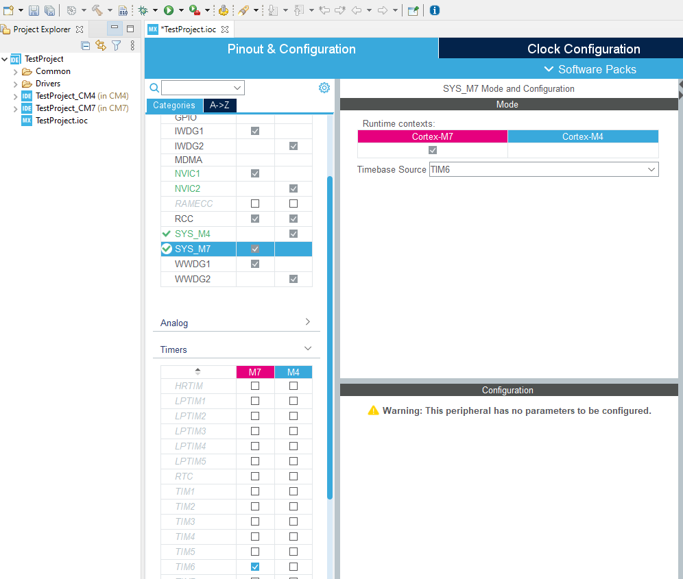

2021-12-15 7:57 AM
this screenshot was taken from STM32CubeIDE 1.8.0, the TIMER 6 is correctly selected as time source for CM7

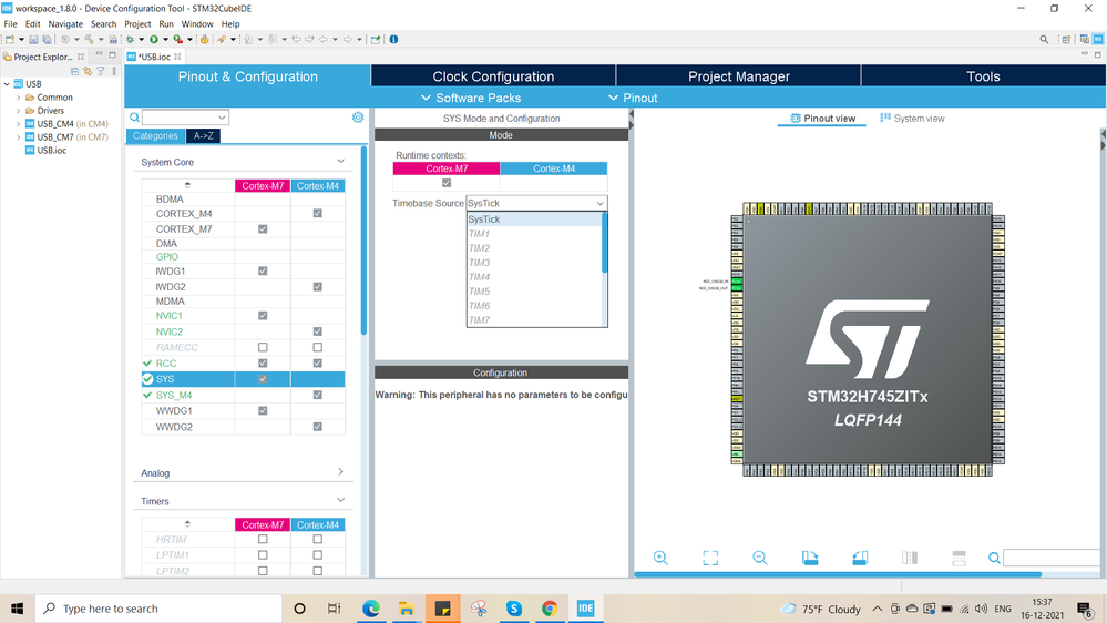

2021-12-16 2:11 AM
Hello ,
I install the latest version 1.8.0.I am sharing the snap shot ,it doesn't give me the selection for TIM6.

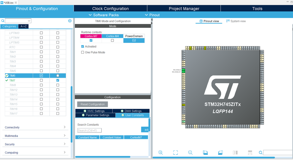

2021-12-16 2:14 AM
it is because you checked the "Activated" Checkbox, that option means that you want to use the TIM6 at your application, unselect that option and this will be fine.
regards
haithem.
2021-12-16 2:22 AM
The problem get solved. Thank You!!!
